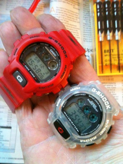

    Red, genuine 6900. The clear 6900 fake has the day digits in the correct place between 1st and 2nd eyes. Text looks reasonable too

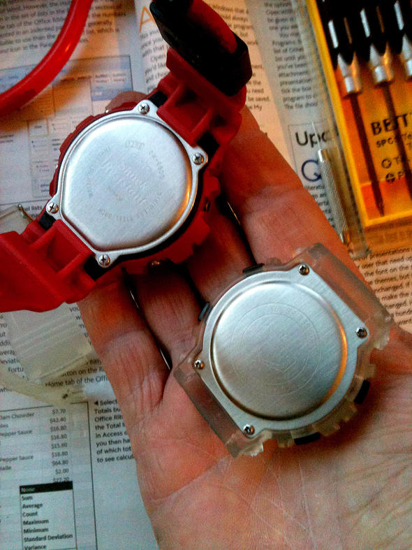

    Wrong shape back, wrong screw heads

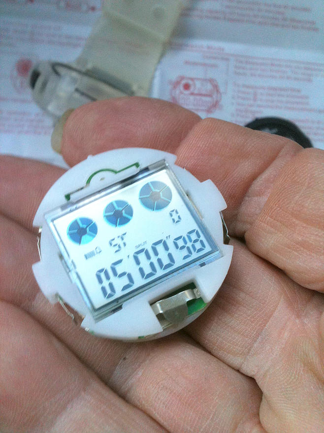

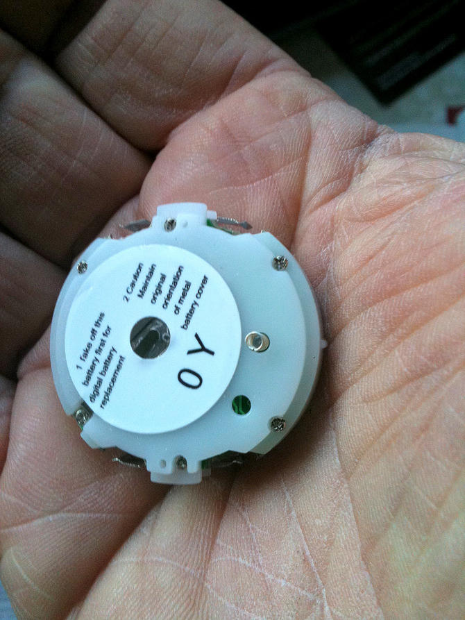

    The module, reasonable quality
    Module is encased in this moulding, no metal cage, no rubber shock absorber.
