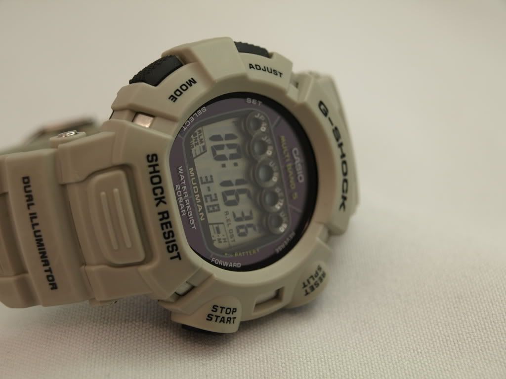

    Esp like the top GW-9010 in the cream muddie clothes, works really well IMHO.
    What's the lower, is that a dyed strap.

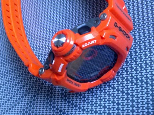

    Don't have many modded Gs, here's about the only one of interest. A vanilla GW-9200 Riseman in a MIRO band and bezel.
    GW-9200 Riseman modded

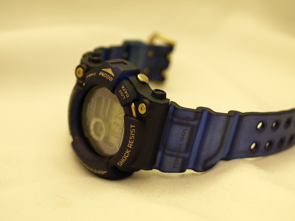

    frog is a GG with strap and bezel dyed a deep navy blue.... almost looks purple.
    Quote Originally Posted by justsellbrgs View Post
    Nice job, the translucent strap looks very

    Did you get your stealthed MIRO from TZ-UK? Think I have the ornage band and bezel here on my vanilla GW-9200, also picked up from there.
