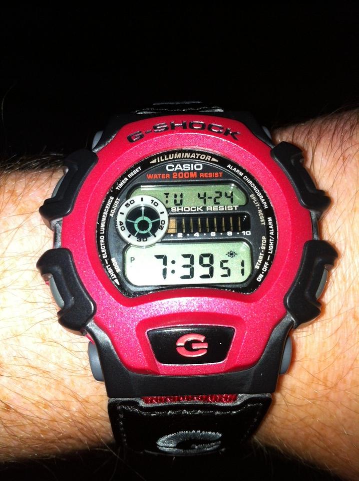

    I have just fixed my DW-004 i thought was gone for good.
    It had sat away for a number of years with a dead battery, feeling guilty I took it and got a new battery in some time ago and was told that the watch was U/S. so I just put it away again.
    Not wanting tp give up on it I just decided to take it apart and have a look myself, and all that was wrong was that it had not been reset!!
    Nice job, always satisfying to get something working again which you'd thought broken. Had a few Gs from various places which were supposedly 'broken' which just needed an AC reset to get them running again....

    Quote Originally Posted by stevenbgs1100 View Post
    Nice work.
    How do you reset them or does it vary between models?
    You short out between the AC contact and the top of the battery.
