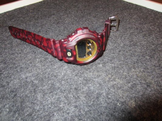

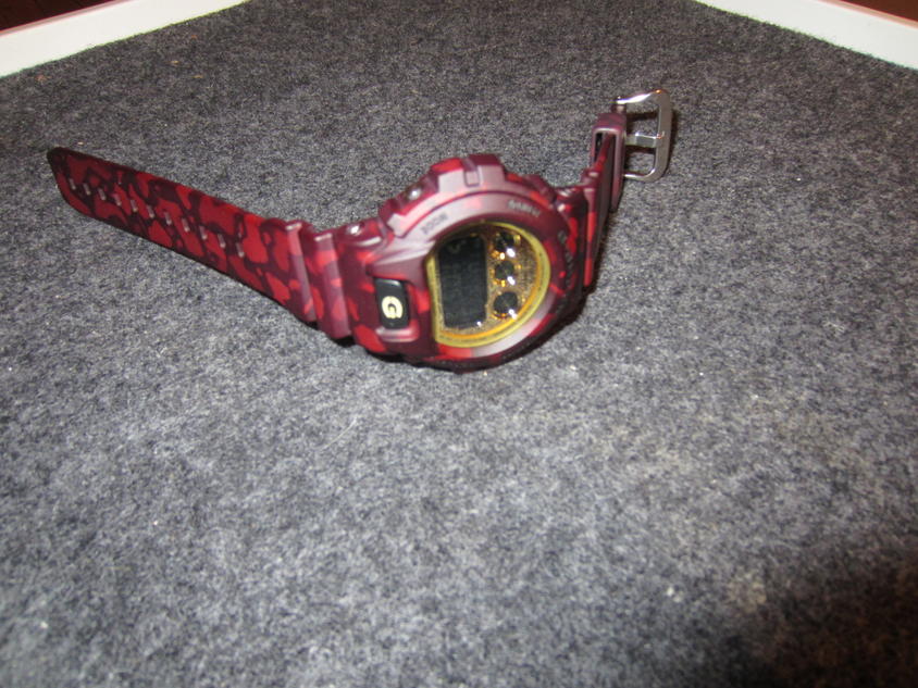

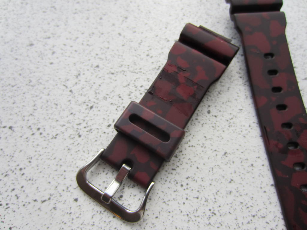

    That's some hot shit right there! Lovin' the gold face. Nice job on the camo! How'd you block off the spots? Can you explain your process?

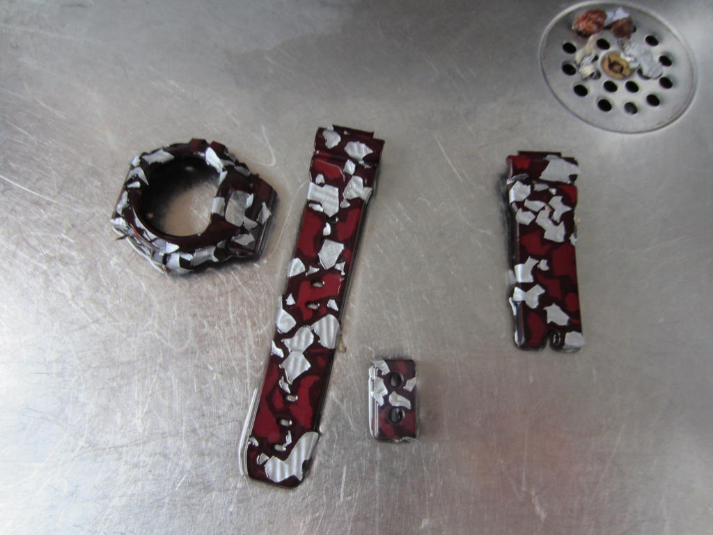

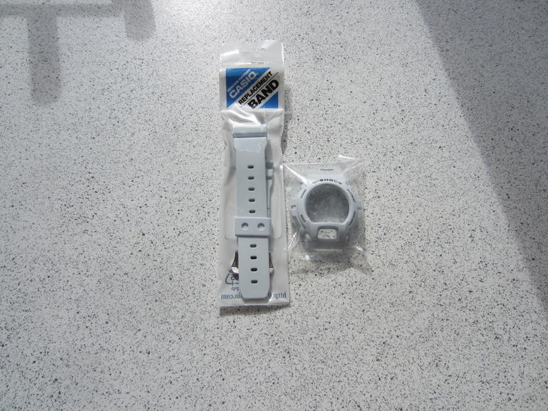

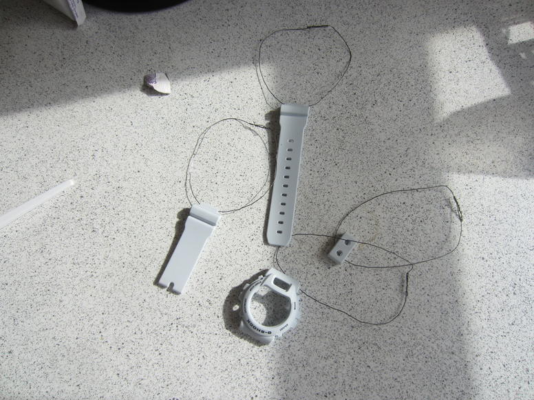

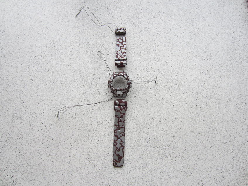

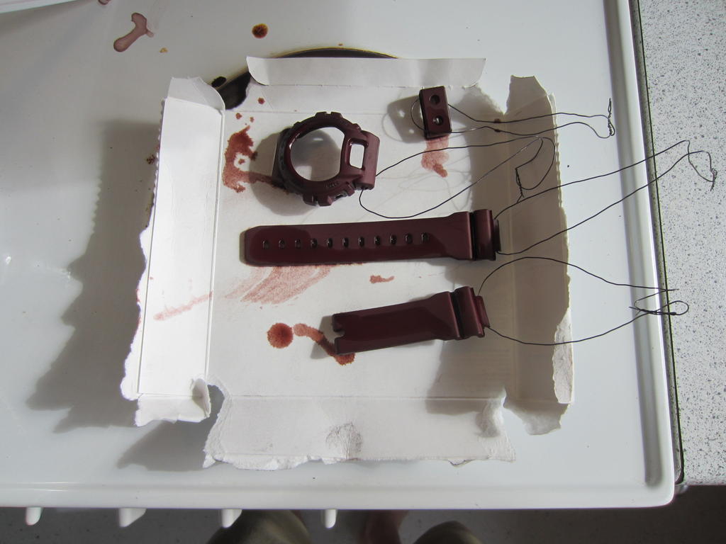

    First i dyede the strap all light Brown, Then i placed small pieces of duck tape (gaffa) in camo patterne....
    Now i dipped the watch in blue dye, after that i removed half of the tape, Then i dipped it in Dark Brown...
    Now you just need to peel of the tape...

    Wow, looks an excellent job, really pro. Did you practice on a spare or was this your first go!!
    What is the mark on the strap 7th pic down?

    The mark is just water, from when rinsing the strap...
    No dry-run just jumped into it
