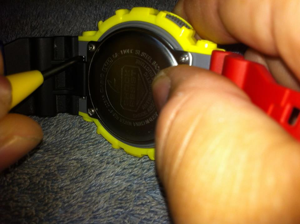

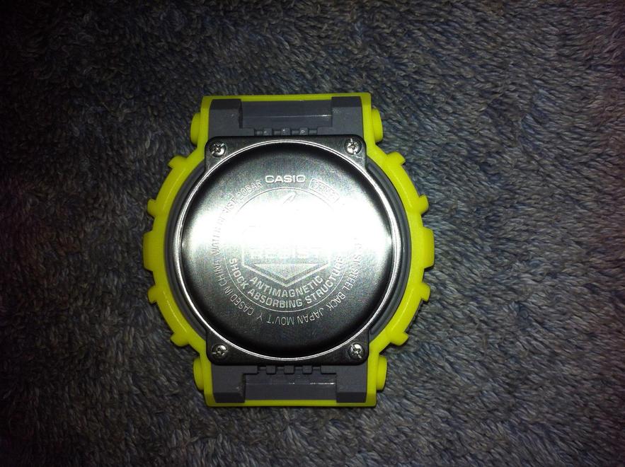

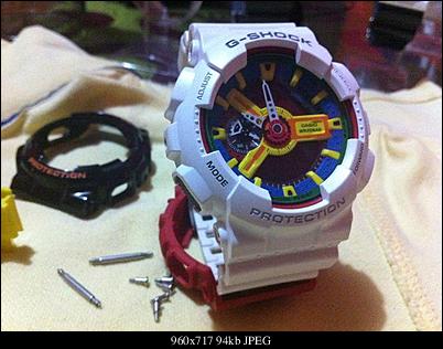

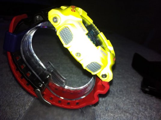

Remove all 6 screws around the bezel
Remove the straps by using s small fine flathead screw driver to remove the spring bar
Part 2 will follow,having problems uploading the pictures

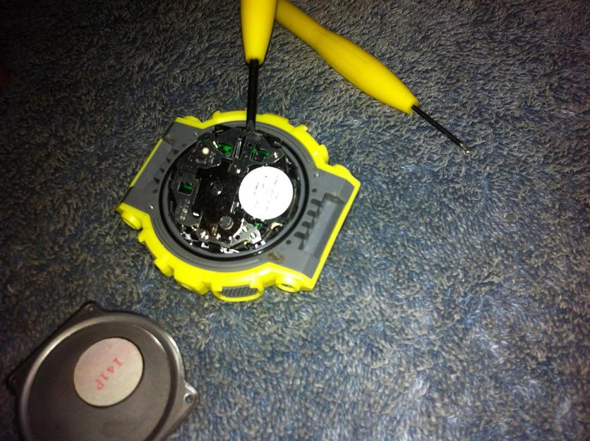

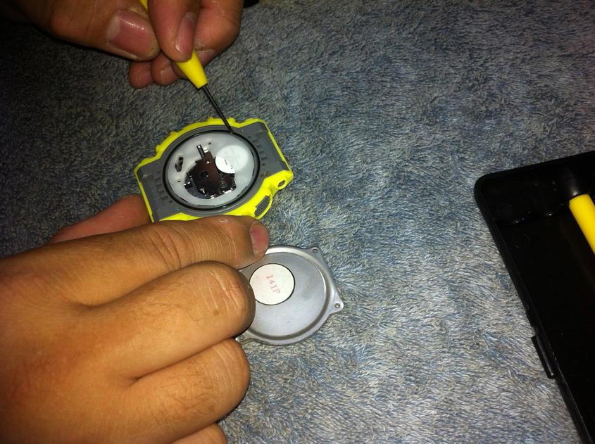

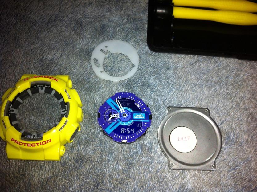

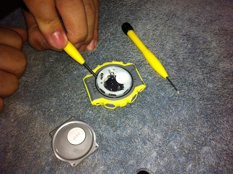

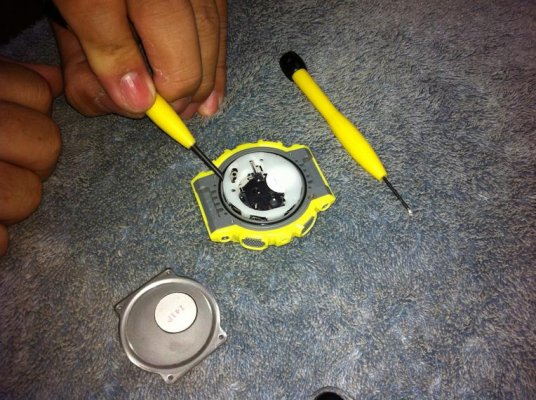

continuation of the Mod
Remove the 4 screws at the back
Remove the white plastic cover
Remove the module

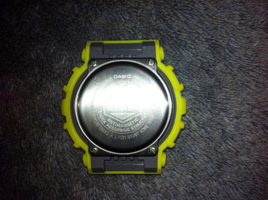

this is the half-finished product
now,to put it back all you have to do is the reverse of everything.

Skidzz, on the 4th picture, the yellow bezel still has grey hour markers on it. Do these not come off, as I'm sure it looks like you have changed these on your other watches.

Nickyc,i stll dont know how to remove the hour marker.It wont easily come off.

I'm confused now (thats not difficult), its just that my yellow ga110, has a yellow hour marker ring, not grey like yours, So i thought you may have swapped it.

so sorry Nickyc,i also changed the bezel that is why its yellow.The gray hour marker came from GA110-1b(i think).I need to search google on how to change the hour hand.

Oh, thats ok. I dont plan to swap the hands or anything. I just wanted to know how to change the bezel and straps and just change over the complete module including the hour markings bit. I got confused as you seem to have separated the module from the grey hour markings section. How is that taken out ? can it be removed as one complete piece with the module.
Basically I want to take my white Ga100, and take out the module, and put my GA110 blue hypercomplex module in instead, and put the white ga100 module in the blue ga110 bezel.
