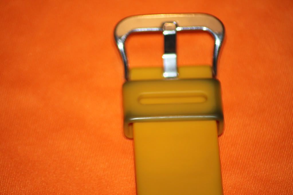

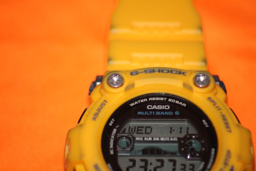

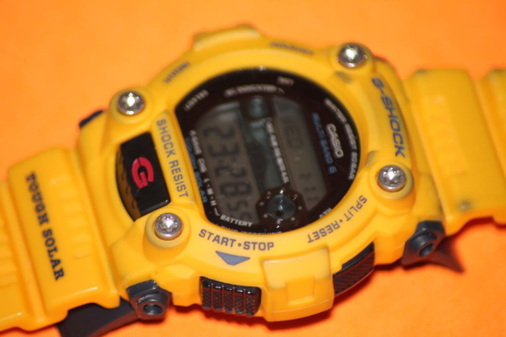

    Hello there, n00b here, but having had a quick look around and seeing some of the restoration work that has been done, I'm pretty sure one of you guys will be able to help me get this watch back to yellow, and my white one back to white, lol!
    I have tried a sponge, soap, washing up liquid, shower gel, tooth brush, and the course thing on a dish sponge, and even bought a magic sponge, to no avail.
    Here's a few pics and any advice is very welcome.

    Good advice there, but the thing is I wear the watch, all my watches in the shower, and wash them separately in the shower too. I think rather than dirt the markings is actually dye or something from clothing. But I can't shift it at all!

    yea the yellow gw7900 looks like the paint from the band keeper is coming off but in the future try not to use anyhting to harsh on the watch bands glossy or matte that magic eraser thing has a lot of chemicals that probably dont go good with resin watch bands good luck though hope it all works out if you know how try dyeing the yellow one the white you cant (idontthink_) but i can be wrong.......

    Bad news on the yellow and white band and bezel. I've heard of clothing dye staining resin in the past, guess this may well be the issue here. Most of Casio's resin bands and bezels (the non-glossy ones at least) are porous and can be dyed, it's quite a common mod to use something like RIT (in the US) or Dylon (UK) to change the colour of a band and bezel. Unfortunately the flip is sometimes the bands and bezels can 'absorb' dye when it's not wanted Once purchased a yellow DW-004 with a stained band and bezel - had intended to dye it anyhow but tried to remove the stains without luck.
    Anyhow enough chat, this is what I'd suggest
    *Clean with soap and a toothbrush - see if you can scrub it clean
    Anything more than this and you risk damaging (a slight risk but worth mentioning) the resin, please do so at your own risk. I'd suggest once you get to this stage it might be worth removing the band and bezel from the case.
    *Clean with a magic eraser
    *Clean with isopropyl alcohol and a toothbrush
    *Clean with acetone and a toothbrush
    I'm unsure if your white G has a matte or glossy band and bezel. If glossy hopefully one of the techniques above will work. If not you might try using a little bleach, I've heard this working. Of course be very very careful with yourself and watch!
    Worst comes to the worst you could dye the whole lot another colour or pick up another band and bezel.
    Interesting to know how you go, let us know. Good luck!

    they arent stains, its just the colour comin off as it rubs on sleeves and such, all mine have done it, especially white ones
