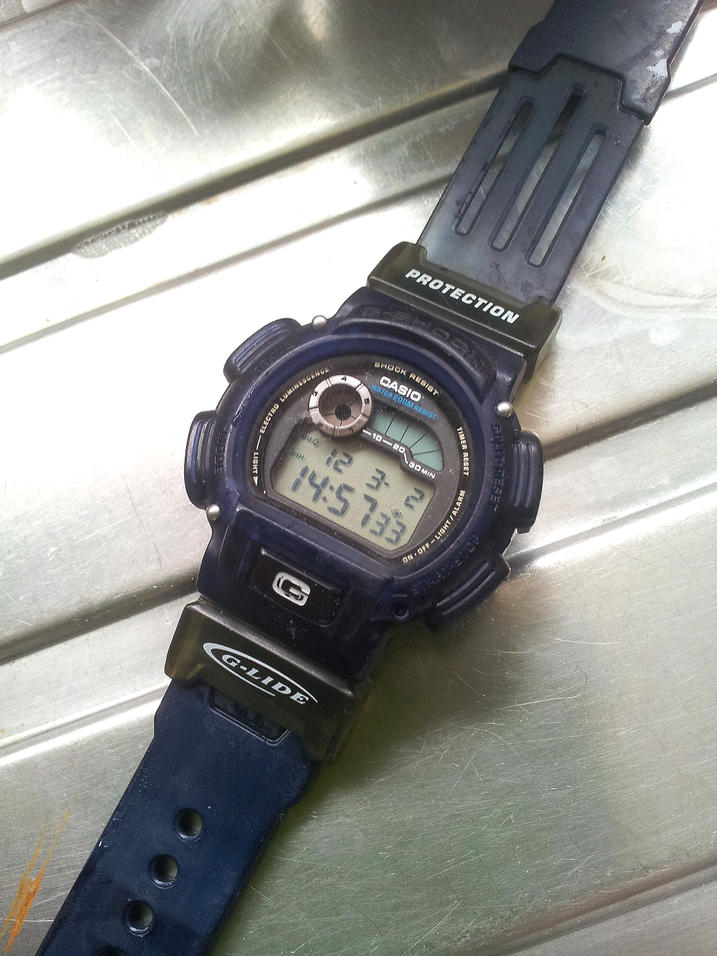

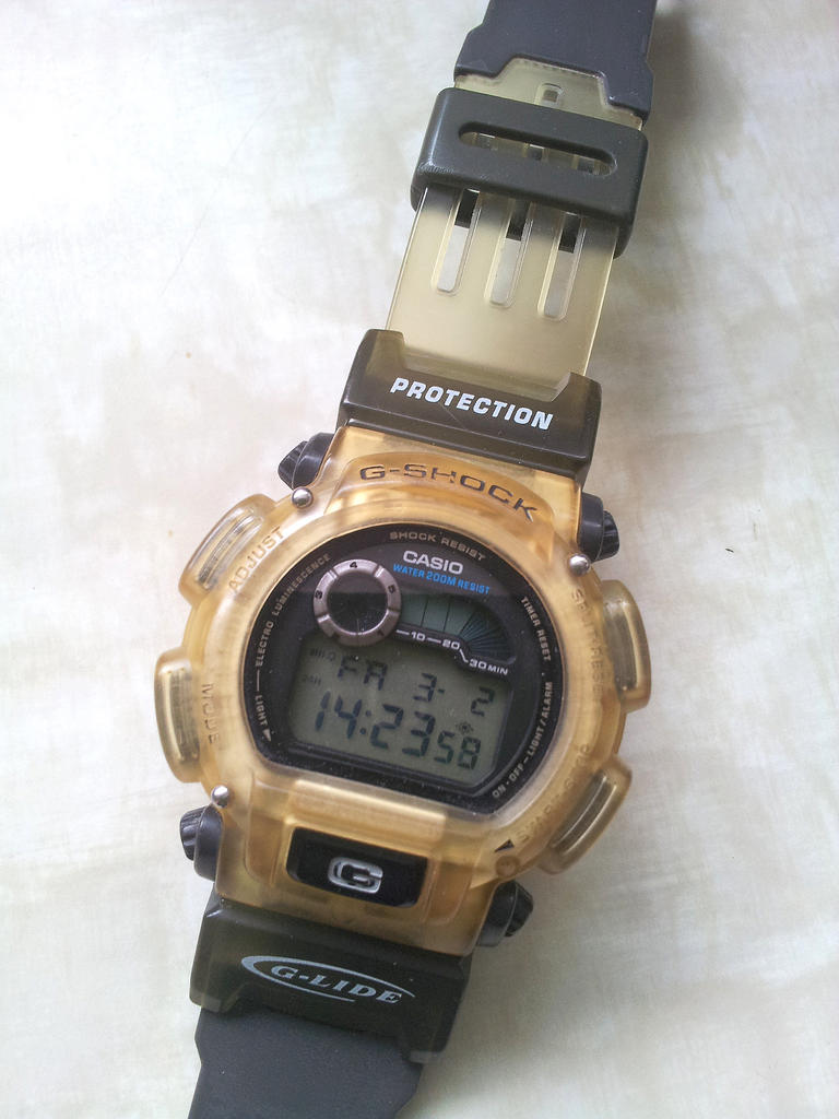

    I wimped out and did a search for RIT in the UK. Got some from The Cloth Shop in North London via Amazon. Bit the bullet this afternoon and tried a poor unsuspecting G-Lide before giving my ICERCS a go.
    First try moderately successful.

    Nice work! Bezel look to have worked really well, strap looks good too. You'll have to do a guide for the site at some point

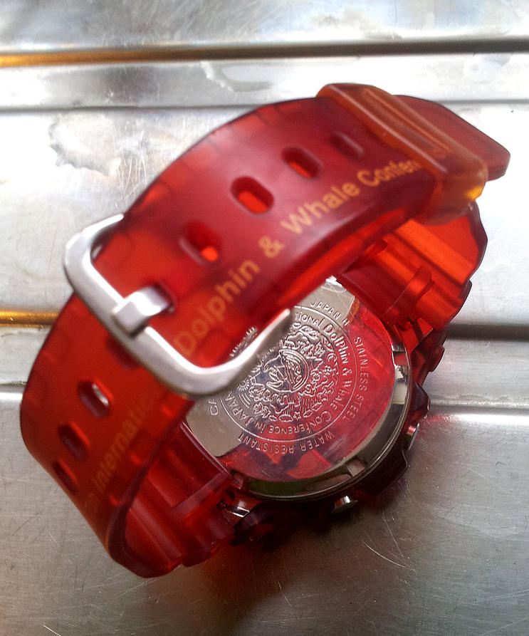

    Ok so I tried, used RIT in a teflon coated aluminium saucepan, no bacon buttie but a large mug of monkey brew. And I did do something irreparable ...

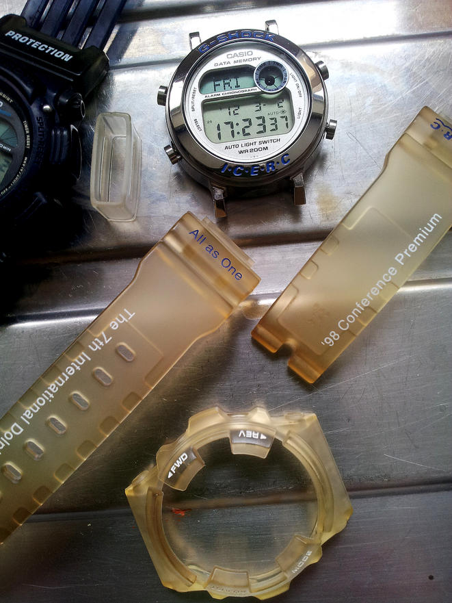

    A naked DW-9200K showing the yellowing of the strap.

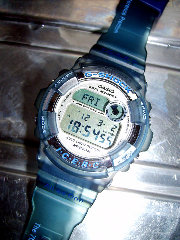

    Blue one first, using the same pan of dye as for the G-lide shown on the left

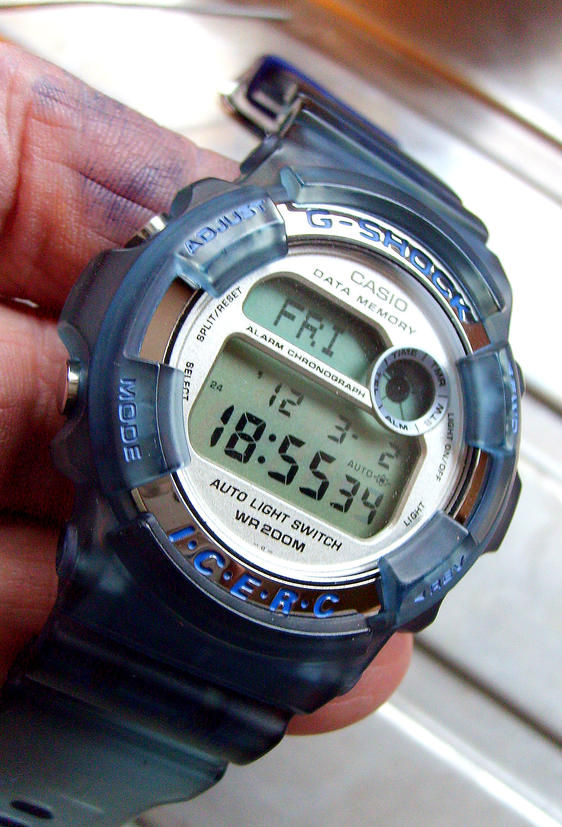

    Hard flashlight gives contrast to white lettering - now light blue and original blue lettering, unchanged. Quite pleased with effect, not an overpowering blue and the transparency of the "jelly" remains.
    View in natural light:

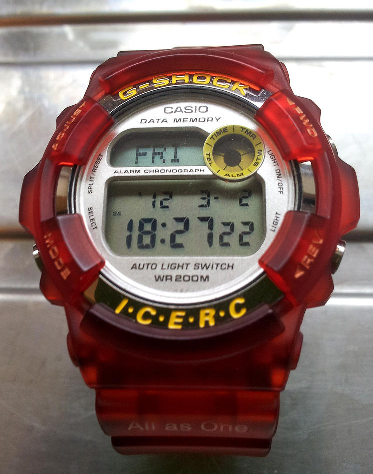

    So, rather than leave my yellow lettered ICERC alone with its almost matching yellowed band I poured away the Royal blue RIT, washed out the pan and added another flavour with, long story short, this result:
    Previous quantities were one third packet of RIT in a 9 inch pan and enough water to cover the components. About 6 minutes in the solution. This time I went for broke and added a whole packet in a similar amount of water. Tangerine flavour. About the same time of immersion, colour didn't seem to get any deeper after the first couple of minutes.

    The yellow lettering on the strap hasn't changed much but the white lettering has changed colour to match:
    Last shot of this one:
    Those few who have reached this far will notice a blue, disassembled ICERC in the background. In fact it is not yet reassembled - put the orange together before the blue.

    i had the keeper from a fake jelly which I dyed. Lost its transparency and when I took the blue ICERC off this morning I had a nice blue imprint of the keeper on my wrist - no dye transference from the strap though

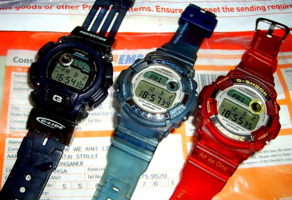

    So here are the three amigos after their makeover:
