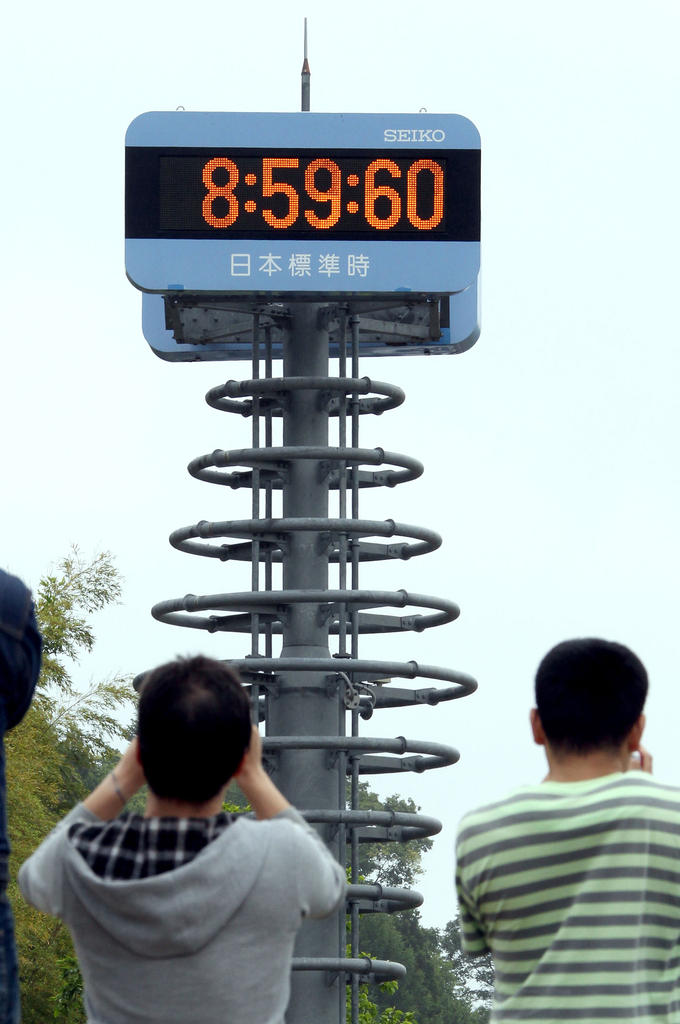

The basic explanation is that once or twice a year there is an extra second added to Coordinated Universal Time (UTC) to keep it in sync with the rotation of the Earth that slows due to tidal action. The Leap Seconds are added either at the end of 30 JUN or 31 DEC, meaning there is currently once or twice a year that the clock counts 60 seconds before it flips over to 00 in a new minutes. This happens simultaneously around the globe at 23:59:60 so it is at different hours in different time zones. A properly programmed clock will give very rare displays of this Leap second:
http://www.wired.com/wp-content/uploads/2015/01/AP120630169536-2.jpg
My question is whether some Casio watches are properly programmed to display this Leap Seconds. The user manuals seem to indicate that the watch can handle Leap Seconds but without detail. There are two things I can think of: A) the watch just syncs with the next time signal and adjusts to match that, or B) the watch is programmed to add a second at the end of the months when the Leap Signal flag is broadcast by WWVB. If B is correct it will be interesting to watch a humble digital wristwatch turn over to 60 seconds.
