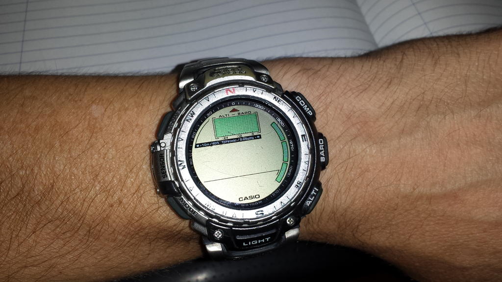

I picked up a PRG-40 Protrek at Goodwill for $35. It needs batteries, so I hope it works!
The first thing I've done is use baking soda and a tooth brush to clean the externals, and it really brought back the bracelet! I was afraid that the Ti bracelet was only coated, but now see that that is not the case. Whew!
The bezel needs to be replaced, as does the body, really. Does anyone know where I can get replacements?
Also, the crystal has some light scratches. Does anyone have a good method of reducing/removing those scratches without making the face look terrible?
Thanks!

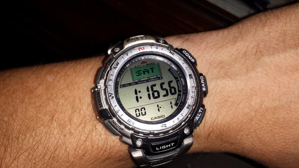

So, semi-good update, today:
I started looking for the best price on cerium oxide, and came across an article that said rock tumblers were affecting the price of cerium oxide because it is used for the final polish of stones. I recalled that my son was given one years ago, and we never did finish polishing stones with it. Sure enough, I had powder, so I used the 3rd stage (polish) and 4th stage (final polish) and was able to remove the damage I'd done to the crystal, as well as minimized the scratches there originally. They're not gone completely, as they are pretty deep, but they're not as noticeable.
Batteries are on the way. I watched a video on replacing them, and got alternative battery numbers. When I entered one of the numbers into Amazon, I found a battery five-pack for $4.65. Can't beat that! They are on the way, and should be here within a week. Now to find a good bezel!

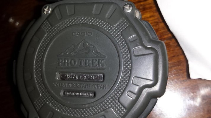

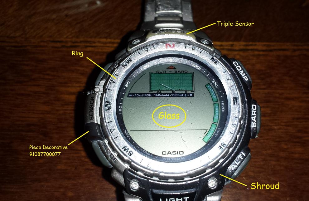

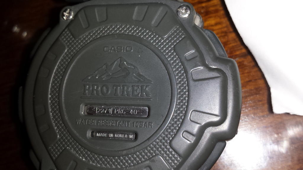

It looks like I'm going to need some more help, folks. The color of this watch and the band matches the Ti model of the PRG-40. However, as you can see from the watch back, there is no T in the model number. Did someone do a conversion?
In looking at the spare parts list on Pac-Parts, I'm having a hard time figuring out which parts to order, as I don't know the names of them. The woman at customer service didn't help me much, either, because she kept calling everything a bezel. In the picture I have attached, I'm looking for the parts in yellow (I believe I've identified the broken piece, as noted by the part number and description), but I don't want to buy the wrong color. Could someone help me figure out the parts I need?
Thank you!
