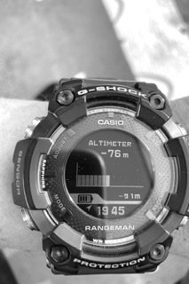

Hello everyone, Jasper here proud owner of a g-shock gpr-b1000 b1 recently purchased.
I was wondering if anyone had a similar issue regarding the altimeter: i read another thread here on the forum but my issue seems a bit crazier.
The altimeter can be updated through barometer (standard) or through gps.
Both think i am -77 m elevation yet i am more like 1 m above sea level here coastal Netherlands.

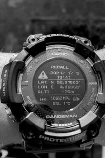

What makes this so strange is that if i use a app to check the elevation with gps.. i get 0-1 m elevation but if i take altimeter reading or even an gps point memory with the gpr-b1000 it gives this crazy -77...
Any thoughts on the matter?
Hope anyone can help!

Fixed it with the next day by using the gps update during a hike... i think i had mistakingly pressed the manual calibration option and triggered the hour waiting time for gps adjustment.
